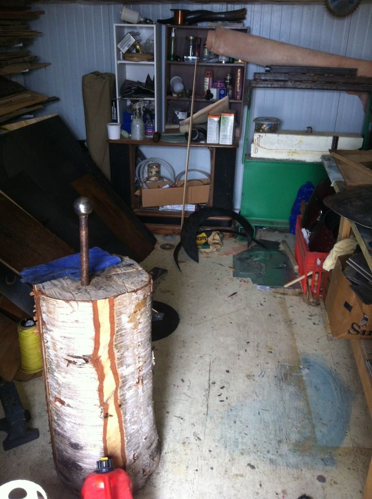

Alright, I didn't get a chance to do much today, just take a few pictures of the workshop.
Here's the setup from the outside - the plastic is wrapped over the forge to make sure it doesn't get rained on (I would bring it inside, but it weighs about four hundreds pounds).

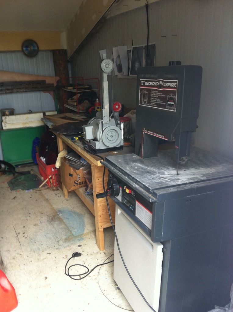

This is my belt sander, bansaw and work table (where I work on patterns/rivetting/leather working)
The object wrapped in hose is an English Wheel (if you aren't familiar with it, it's a kind of steel press that allows you to bend/shape steel, but does have the downside of stretching/thinning it).  Also pictured is my press.

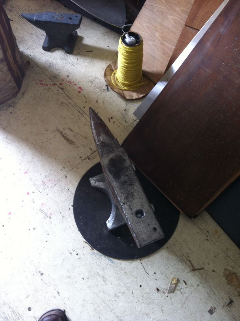

And here's the three most important tools that an armourer is ever going to need.  A stump for dishing steel (the dishing on my stump is covered by that glove I just realised), a ball-stake (I have a couple of them, but that's the one I use most often), and an anvil (the larger anvil (75 pounds) I use for most of my work, the smaller anvil (30 pounds) is for rivetting and other small scale stuff.
Ultimately, if you want to start armouring, you only need a few items, and everything else will come as you feel more comfortable and start seeking out other stuff.
1.  A stump.  Not kidding.  An ordinary tree stump.  It is the most important thing you will ever have, so make sure it's a solid one.  Dish a shallow circle (or a couple, depending on stump size) into the top of it, and you just hammer sheet steel into the shallow dish, force-shaping the steel.
2.  A stake or two.  These can be specially ordered from blacksmith sites on the internet, but I just made mine out of large ball bearings and other metal spheres I've managed to acquire over the years, welded to metal rods.  You use these for more fine detail shaping and for planishing (planishing steel is to lightly hit it with a polished hammer against a smooth solid, and it is how you remove hammer marks after you've dished the steel.
3.  Hammers.  You'll probably only use two to three hammers right away.  A rubber mallet is what I use for initial shaping, or when I need to quickly bend a piece of steel into a shape without denting it.  A ball-peen hammer is absolutely necessary for riveting and other tasks.  Finally, you need a big, flat-faced hammer (all non-rubber hammers should have their faces kept polished) for planishing.
4. Sheet steel (and a way to cut it).  A ban-saw isn't cheap, but it's possible to cut fourteen gauge steel with steel shears.  It isn't fun, but it's what I did initially, so definitely possible.
5.  An anvil, or a railway rail (the steel beams that trains ride along) for a multitude of tasks.  This is the most expensive/hard to find piece you'll need to get ahold of.
That's really all you need to get ready and start armouring.  Rivets, leather strips for strapping, et cetera are all fringe pieces you'll need but to simply begin banging steel into a harness, those above things are all you will need.

Thread resurection!
The tiny-headed helmet thread reminded me that I had made this thread.  Although school's been wrecking most of my time, I do have some shots of some work of a friend of mine:
It was his first attempt at chasing brass, and his first attempt at acid-etching steel.  I think it looks absolutely fantastic.
Here's a couple of random pictures I found amidst my folders.  The first one is of another friend, who made the sallet from an earlier post that's he's actually wearing in this picture:
